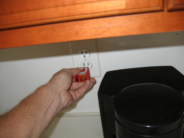

Countertop and Work Surface Receptacles

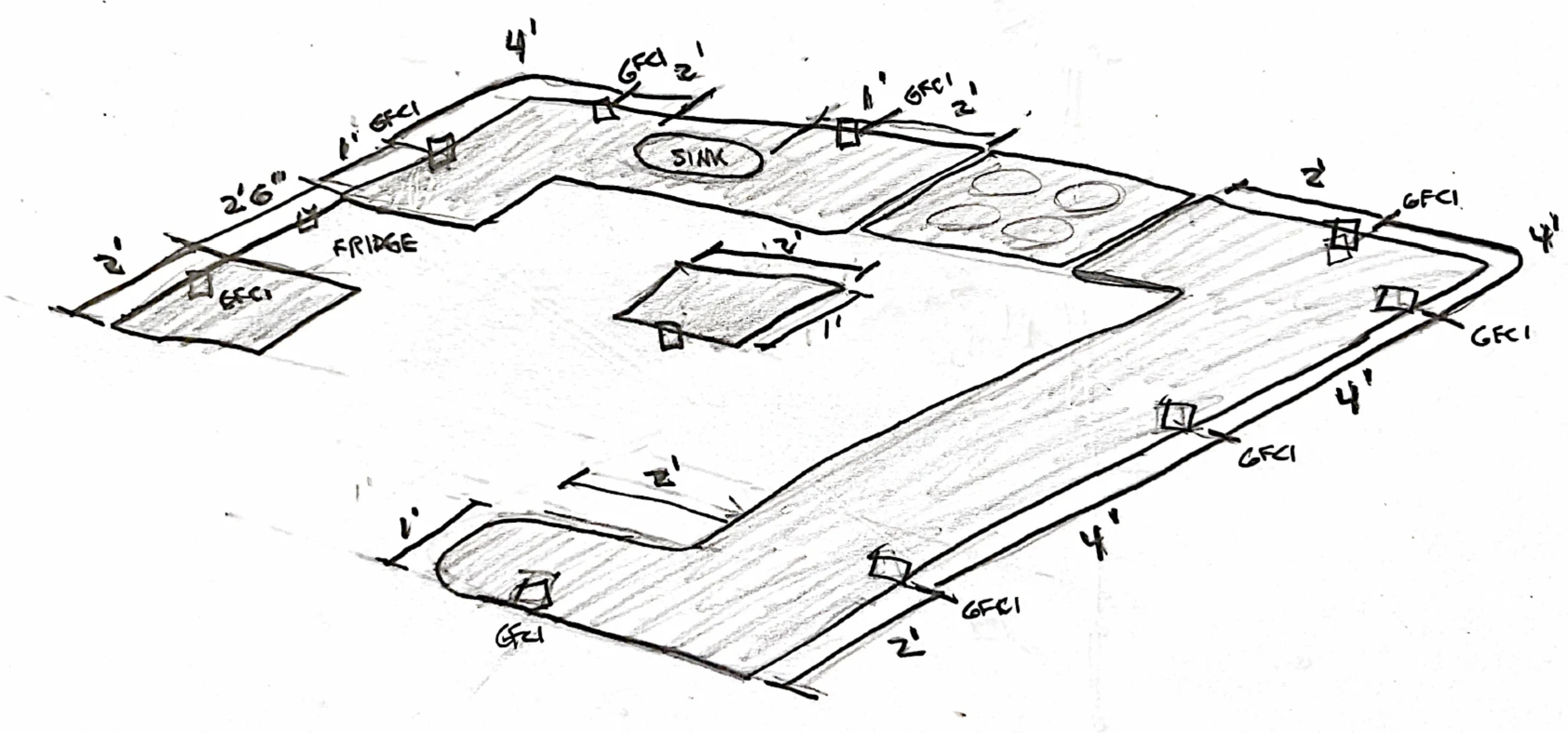

Any countertop or work surface that is 12 inches (305 mm) or wider must have receptacles installed. Receptacles must be placed so that no point along the wall behind the countertop is more than 24 inches away from a receptacle. This means you’ll always have a plug within reach for plugging in your appliances.
Wall Countertop and Work Surface Receptacle Spacing
  • Receptacle outlets must be installed:
    • At each wall countertop or work surface 12 inches (305 mm) or wider.
    • So that no point along the wall line is more than 24 inches (610 mm), measured horizontally, from a receptacle outlet.
  • Exceptions:
    1. No receptacle is required on walls directly behind a range, counter-mounted cooking unit, or sink.
    2. If a required receptacle cannot be installed on the wall, it can be installed as close as practicable to the countertop area it serves.

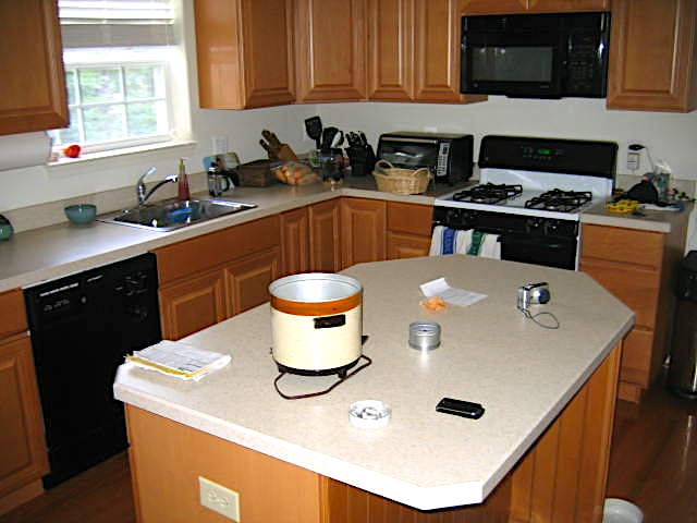

Island and Peninsula Countertops and Work Surfaces
The rules about installing receptacle outlets based on the square footage of countertops and work surfaces on islands and peninsulas have been eliminated. More importantly, the requirement to install any receptacles on islands and peninsulas has also been removed.
  • Receptacle outlets for islands or peninsulas are optional and not required. This is an update from older codes. If an outlet is installed on an island or peninsula countertop, it must meet the specific requirements for placement and spacing.
  • If no receptacle outlet is provided, provisions for future installations must be made (e.g., wiring, conduit, junction box). Even if an outlet is not currently installed, the island or peninsula must still be set up to allow for an outlet to be added in the future.

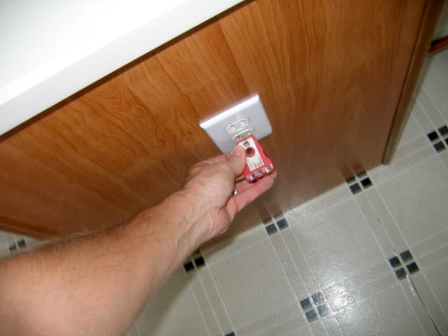

Safety Hazard

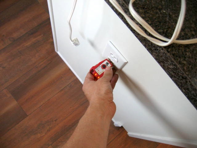

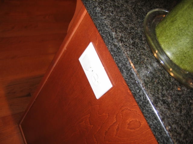

Children are especially at risk, as they could pull on cords plugged into kitchen and peninsula receptacles and spill hot contents, causing burns and other injuries. The Consumer Product Safety Commission states that between 1991 and 2020, an estimated 9,700 people, many of them children, were treated in U.S. emergency hospitals for burns and other injuries after pulling on or running into power cords plugged into receptacle outlets installed below island and peninsula counter and work surfaces.
If a home inspector observes a receptacle installed on the side of the island or peninsula below the countertop of a kitchen island or peninsula, the inspector may communicate in the report an observed safety hazard. Regardless of when the safety hazard was installed and permitted in the past by the older versions of the building code, a safety hazard is a defect.

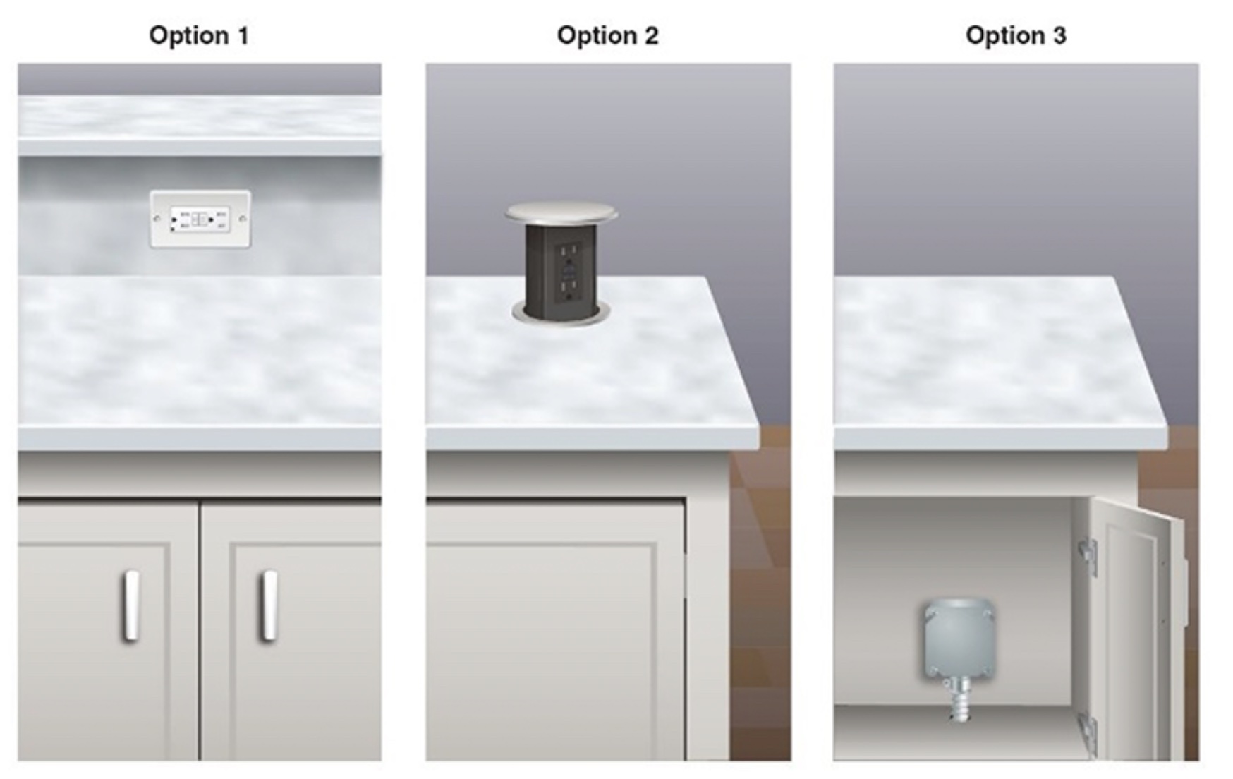

Receptacle Outlet Location Options
The NFPA provides the following illustration to help inspectors understand the options.
For wall, island, or peninsula receptacle outlets, the placement options are as follows:
  • Above the Countertop or Work Surface: No more than 20 inches (508 mm) above the countertop or work surface.
  • In the Countertop: Must use receptacle outlet assemblies listed for countertop use.
  • In the Work Surface: Must use assemblies listed for work surfaces or countertops.

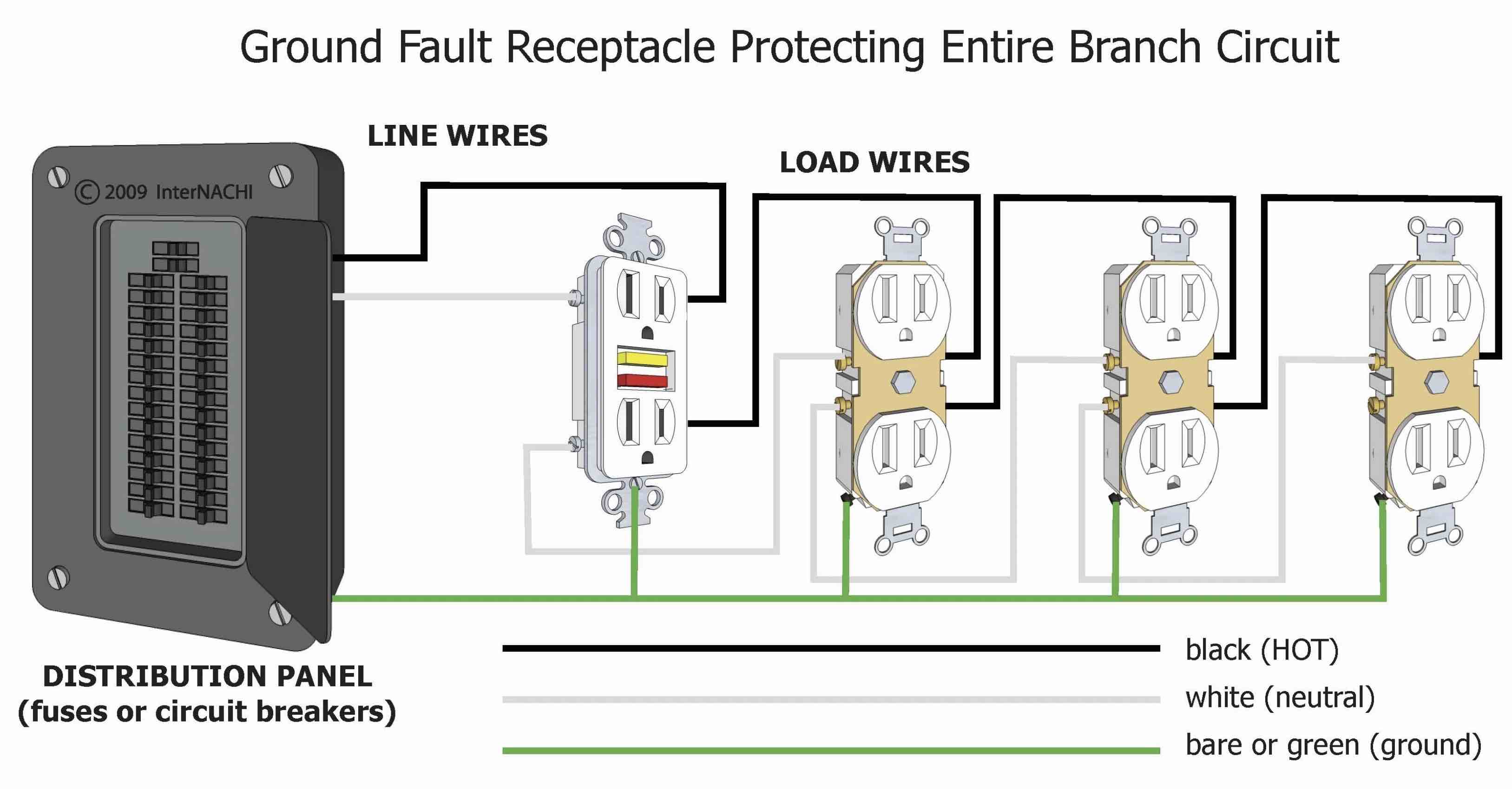

GFCI Protection for Kitchen Counter Receptacles
All kitchen countertop receptacles must have Ground Fault Circuit Interrupter (GFCI) protection as required by code. GFCI protection reduces the risk of electric shock by disconnecting the circuit when a ground fault occurs. This applies to all receptacles serving countertop areas, regardless of location (wall-mounted, islands, peninsulas, or within the surface).

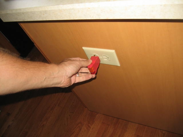

  • Ensure no receptacle outlets are below the countertop or work surface.

Safety Hazard
  • If a receptacle is observed to be installed at the kitchen island or peninsula below the countertop or work surface, the inspector should inform the client of the safety hazards, especially to children.
