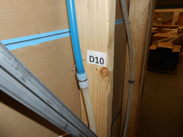

Observation
ABS fitting is glued to PVC.
ABS and PVC are not actually glued in the regular sense of gluing. The so-called "glue" is actually a solvent that melts the surfaces of the pipe and fitting for a few seconds. When you slide the joint together, the two surfaces blend together. The process is properly called "solvent welding". It is much the same as welding metal. One process uses heat to melt the two surfaces the other uses chemical reaction. The problem is that ABS and PVC are different materials and each requires its own solvent to melt the surfaces.

Cold water line to the shower head is not secured. 3/8” thru 1” PEX shall be secured at a minimum of every 32”.
Observation

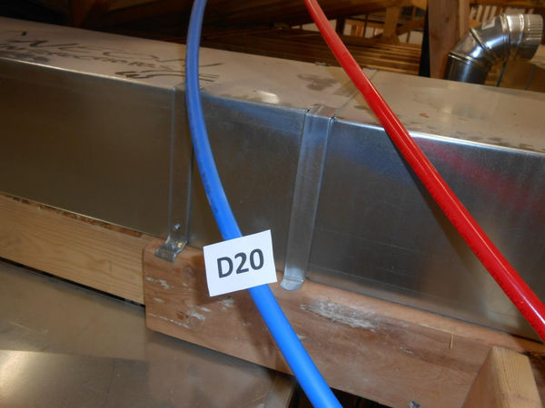

Observation
3/8” thru 1” PEX shall be secured at a minimum of every 32”. Plumbing water lines should not be installed in unconditioned areas unless the local climate is suitable.
Observation
