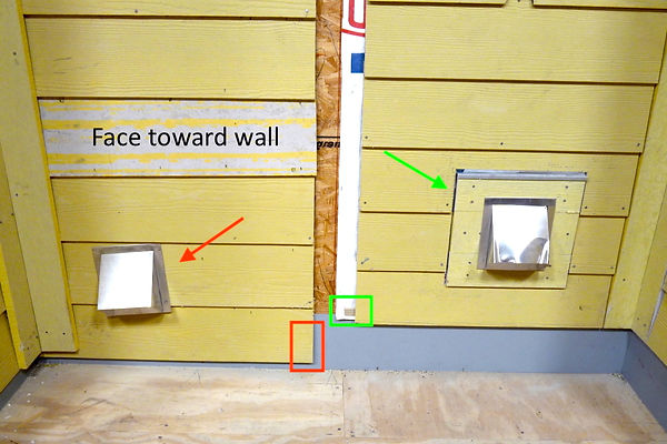

Siding installed with the face toward the wall.

Dryer vent installed too low.

Improper dryer vent installation (not installed over trim blockout).
Siding contact with foundation.
