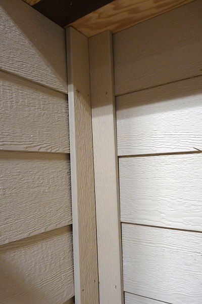

Observation
Trim overlapping siding is improper.
Observation

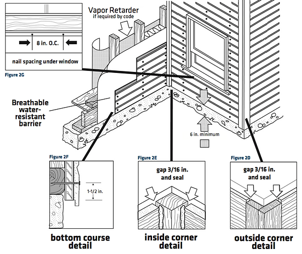

Siding butted tight to trim (all siding should have 3/16” min. gap).
Fastened with staples.
Cut edges not primed/painted.
Face-nailed.
Face nails beneath windows spaced > 8” oc and not caulked.
Nails < ⅜” from ends and < ¾” from top of board.
Observation
No waterproof barrier strip installed around window.
Less than 6” clearance from grade.

Installation Details:
