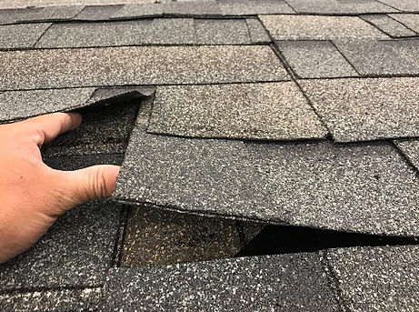

There are shingles that have missing fasteners. They are loosely laying on top of the roof, including this shingle at the left-side, near the head wall.

Missing fasteners at the shingle to the left of the vent pipe penetration.

Missing fasteners at the shingle near the gutter end.

There are loose shingles around the skylight. Missing fasteners at shingles.

![roof-38-skylight-InterNACHI-Inspection-School](https://static.wixstatic.com/media/ebd5e8_ba34df75096d4954b7a690014699873a~mv2.jpg/v1/fill/w_600,h_445,al_c,q_80,enc_auto/ebd5e8_ba34df75096d4954b7a690014699873a~mv2.jpg)
There are 3-tab shingles installed to the left of the skylight. The shingles are of a different type of shingle originally installed on the roof. This is improper and makes this area unreliable. This may indicate a patch on the roof made by a homeowner or unprofessional contractor. Major defect.
Observation
There are indications of torn shingles installed around the skylight. This is an indication of improper installation or poor workmanship.
