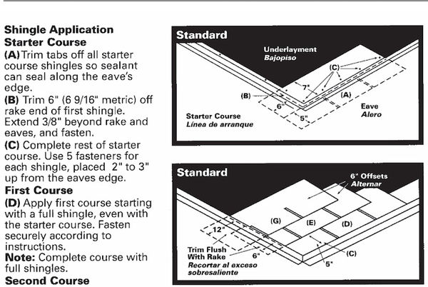

STARTER STRIP
The starter strip functions to help shed water off the roof at the eaves and rake areas. By adhering to other shingles, the strip also adds strength to the shingles layer above. The starter strip also provides a nice looking, straight edge at the eave and rake areas.
Observation
![roof-starter-strip](https://static.wixstatic.com/media/ebd5e8_045347c33894432f80f6a11418bcbb8f~mv2.jpg/v1/fill/w_600,h_449,al_c,q_80,enc_auto/ebd5e8_045347c33894432f80f6a11418bcbb8f~mv2.jpg)
The shingle manufacturer requires a starter strip to be installed along the eaves.
![roof-starter-strip-upside-down.jpg](https://static.wixstatic.com/media/ebd5e8_b51c631ba8a94a75998140d75081972a~mv2.jpg/v1/fill/w_600,h_447,al_c,q_80,enc_auto/ebd5e8_b51c631ba8a94a75998140d75081972a~mv2.jpg)
The starter strip on the roof is incorrectly installed. It's upside down. The adhesive strips should be facing upwards.
![roof-starter-strip-fasteners.jpg](https://static.wixstatic.com/media/ebd5e8_39e3847dcd7c4c5693338c65e8f9fd01~mv2.jpg/v1/fill/w_600,h_448,al_c,q_80,enc_auto/ebd5e8_39e3847dcd7c4c5693338c65e8f9fd01~mv2.jpg)
The starter strip is also required to be secured with 5 fasteners, placed 2 or 3 inches up from the eaves edge. But only a few fasteners were installed, and they were installed in the incorrect location.
![roof-starter-strip-offset.jpg](https://static.wixstatic.com/media/ebd5e8_dab3b0233ade4c708f47b1c2d3cda1d3~mv2.jpg/v1/fill/w_600,h_450,al_c,q_80,enc_auto/ebd5e8_dab3b0233ade4c708f47b1c2d3cda1d3~mv2.jpg)
Six inches were to be cut and removed from one end of the starter strip, so that there is an offset with the full shingle above it, but this was not done. As you can see, the opening between two shingles is improperly positioned directly above the opening between to starter strips. This condition of having no offset pattern will allow water to penetrate the roof shingle layer and the starter strip.
Installation conditions were easily observed prior to the shingles being installed.
Observation
![roof-starter-strip (1).jpg](https://static.wixstatic.com/media/ebd5e8_ca03815946334ee9bd62f75189279703~mv2.jpg/v1/fill/w_600,h_449,al_c,q_80,enc_auto/ebd5e8_ca03815946334ee9bd62f75189279703~mv2.jpg)
The shingle manufacturer requires a starter strip to be installed at the eaves.
Six inches were to be cut and removed from one end of the starter strip so that there is an offset with the full shingle above it, but this was not done.
