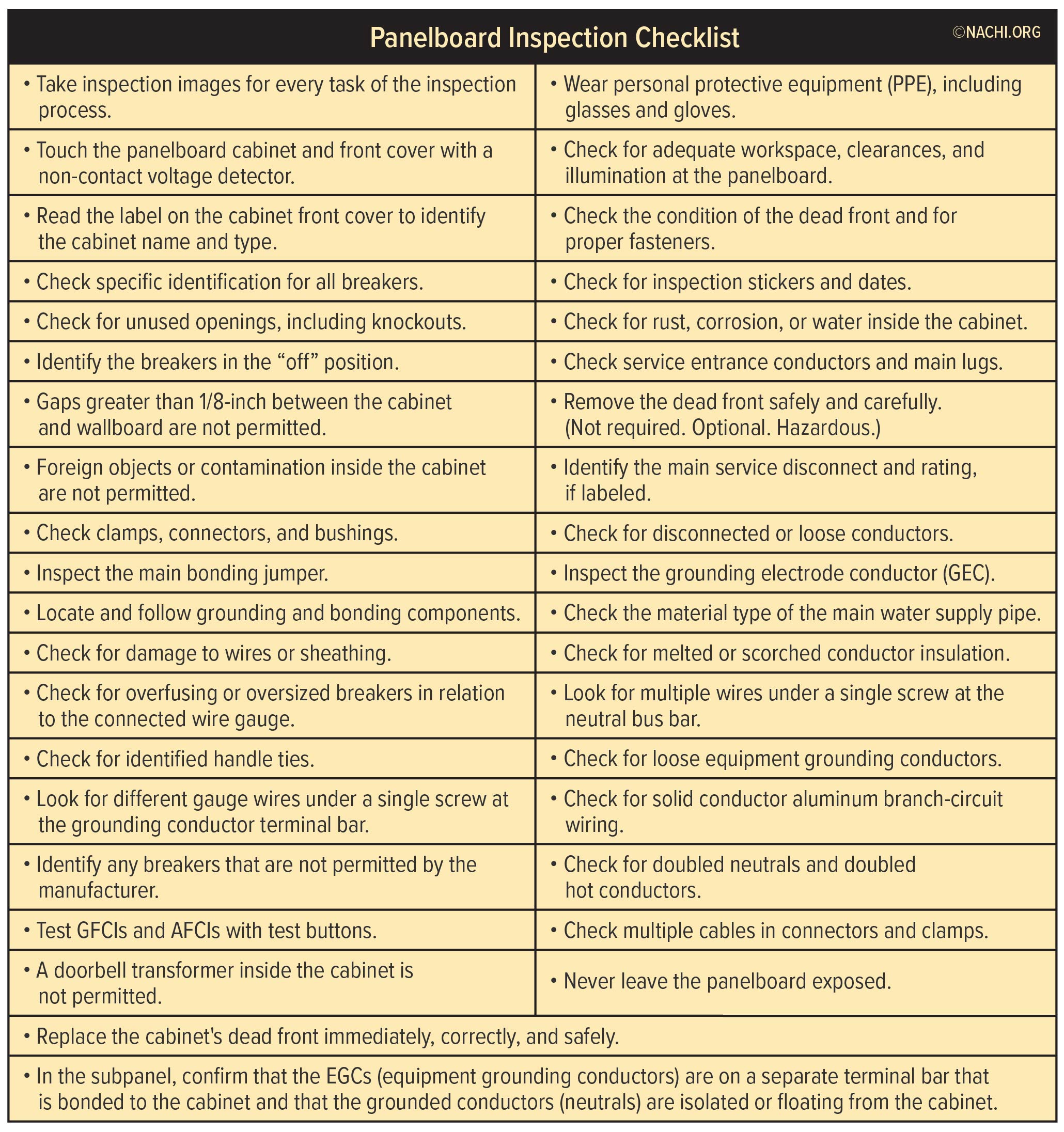

Panelboard Inspection Cheklist
Panelboard inspection checklist.
