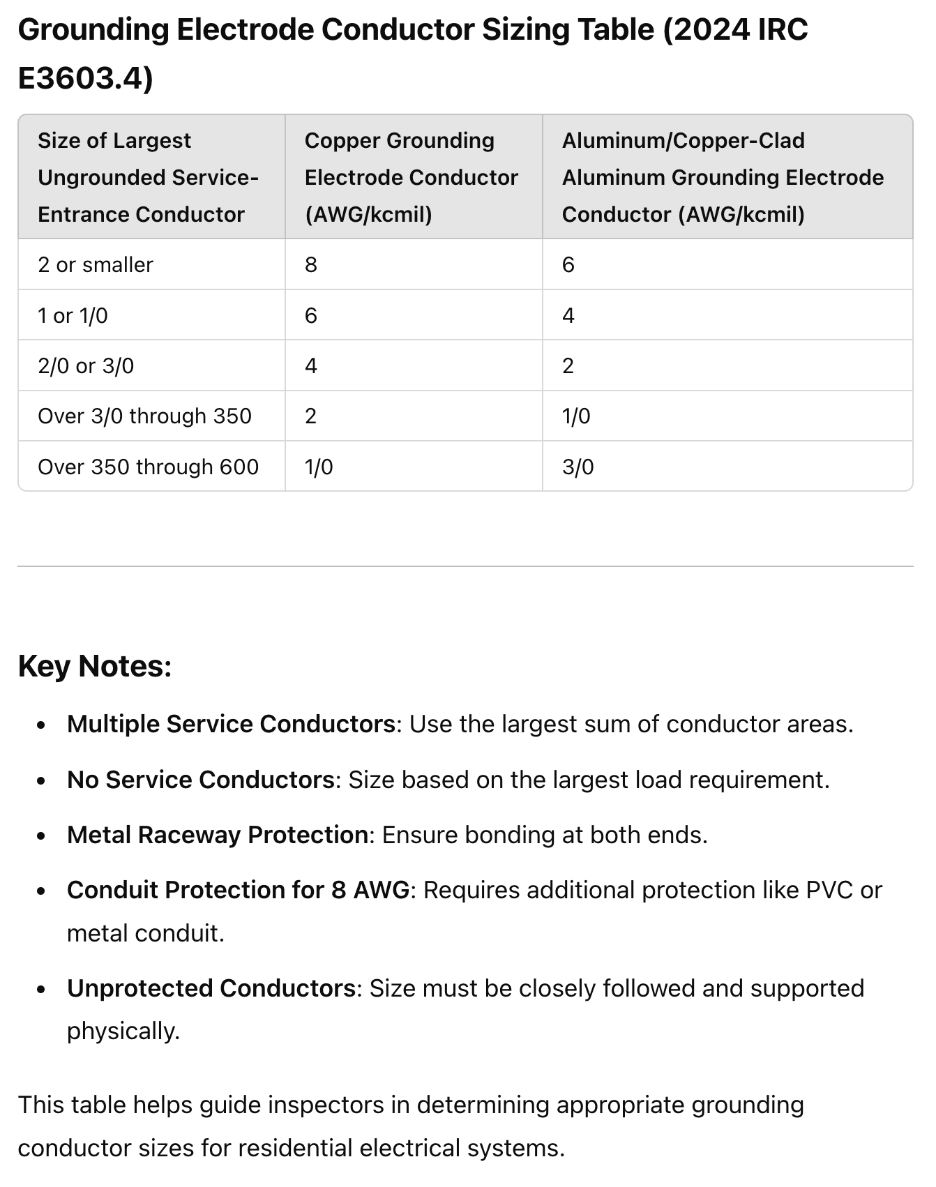

Grounding Electrode Conductor Sizing Table
This table helps guide inspectors in determining appropriate grounding conductor sizes for residential electrical systems. Reference: 2024 IRC Table E3603.4.
