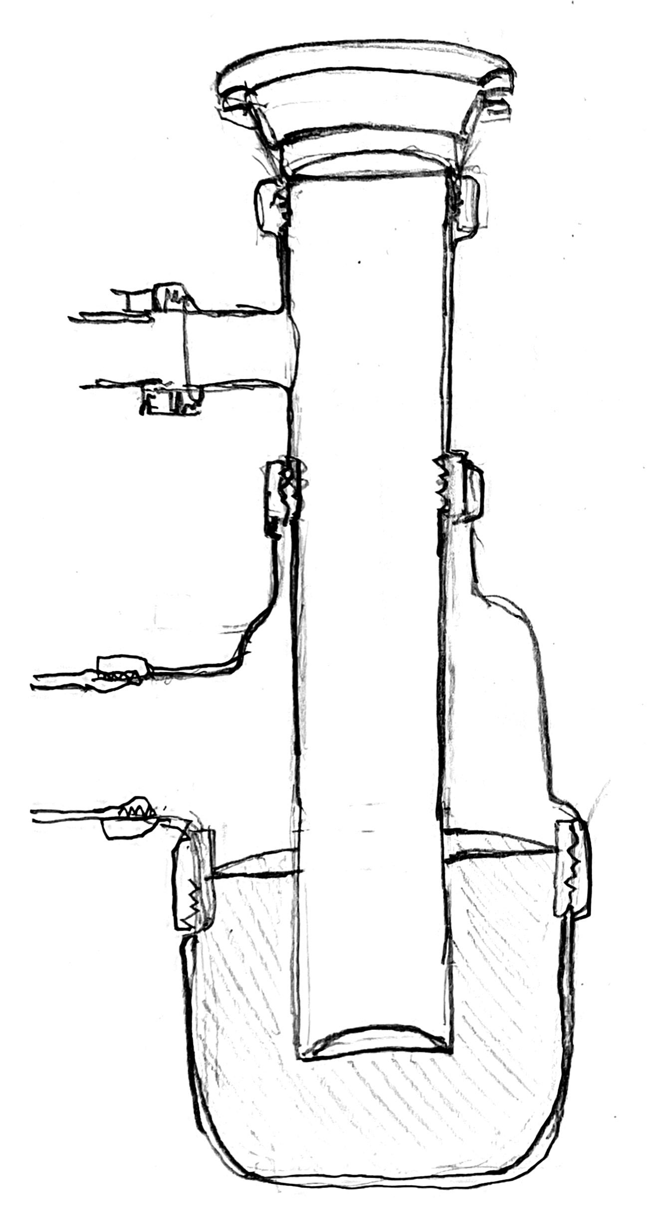

Bottle Trap
Bottle traps, also known as partition traps, are plumbing traps that utilize an internal partition to separate the house from the sewer side. According to the 2024 International Residential Code (IRC) Section P3201.5, traps with internal partitions, such as bottle traps, are prohibited.
