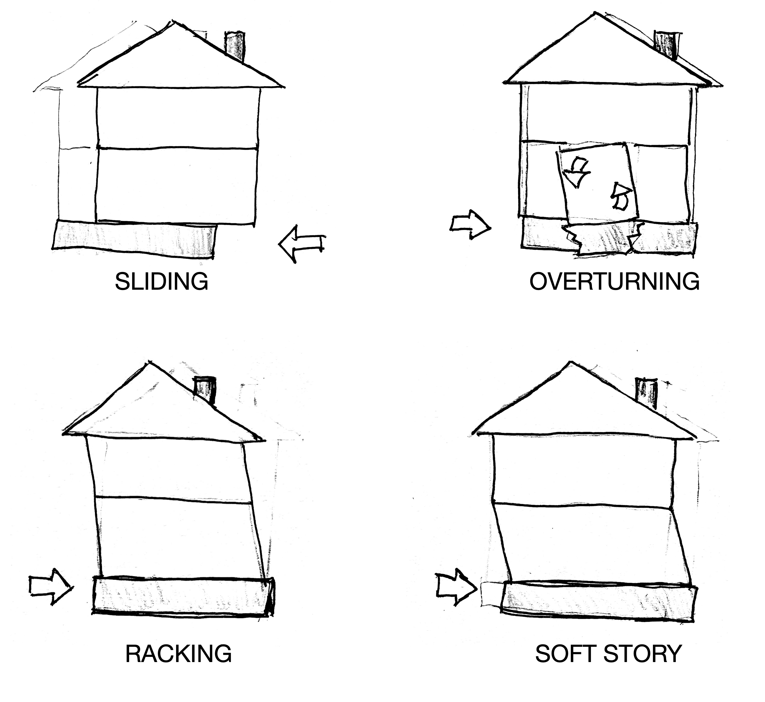

Four Types of Seismic Lateral Forces on a House
While hurricanes and tornadoes primarily create uplift forces, earthquakes generate predominantly lateral (horizontal) forces that affect buildings in unique ways. Understanding these differences is crucial for proper inspection of foundation anchorage systems.
During an earthquake, the ground beneath a home accelerates horizontally in multiple directions.
While hurricanes and tornadoes primarily create uplift forces, earthquakes generate predominantly lateral (horizontal) forces that affect buildings. Sliding: The entire house can shift off its foundation when earthquake forces push it sideways, especially if it's not properly anchored. Overturning: Walls or structures may tip or turn over due to strong horizontal shaking. Racking: The house's frame can distort into a parallelogram shape—this often happens when bracing is inadequate. Soft-story failure: A lower level with large openings (like garages) lacks enough lateral support, making it prone to collapse while upper stories stay intact.

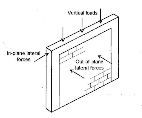

Two Types of Seismic Plane Forces on a Wall
Seismic forces affect walls in two primary ways, both requiring specific anchoring solutions:
In-Plane Forces (Parallel to Wall)
What happens: Forces push and pull parallel to the wall length
Potential failures:
  • Anchor bolts can shear, allowing the building to slide off its foundation
  • Partial anchor bolt failure can create uplift on one side, causing walls to overturn
Resistance elements:
  • Anchor bolts connecting sill plates to foundation
  • "Shear nailing" (nails attaching wall sheathing to top plate, studs, and sill)
What to inspect: Proper anchor bolt placement, size, and spacing; appropriate sheathing attachment
Out-of-Plane Forces (Perpendicular to Wall)
What happens: Forces push walls backward and forward like a swinging door
Potential failures:
  • Walls tilt and flex
  • Perpendicular walls rack out of plumb
  • Floor and roof diaphragms may rotate (torsion)
  • "Soft story" collapse (when a lower story with large openings supports significant weight above)
  • Connections between wall top plates and floor/roof framing
  • Anchor bolts in sill plates
  • Proper bracing around large openings
What to inspect: Connection integrity between walls and horizontal diaphragms; adequate reinforcement around garage doors and other large openings

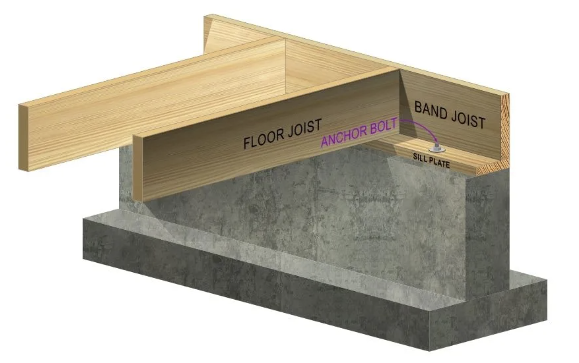

Why Foundation Anchorage Matters
Foundation anchorage serves as the crucial transfer mechanism between a building's frame and its foundation. Various lateral forces—including wind pressure, earthquake movement, soil pressure, and foundation settlement—must be effectively transferred through the structure to maintain stability.
When installed according to code requirements, anchor bolts provide the necessary capacity to resist these forces and maintain the building's stability during stress events. Think of this anchoring system as creating a unified structure from what would otherwise be separate components.

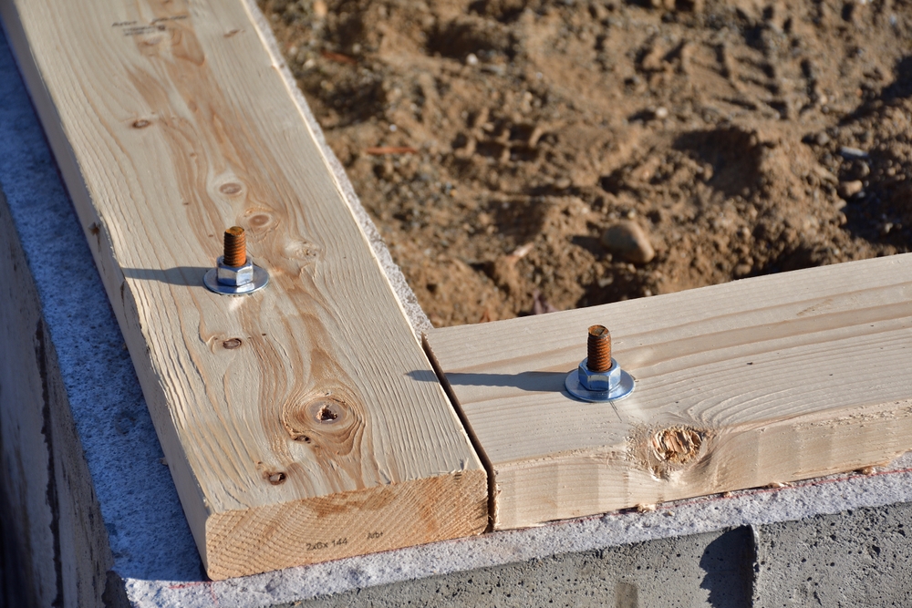

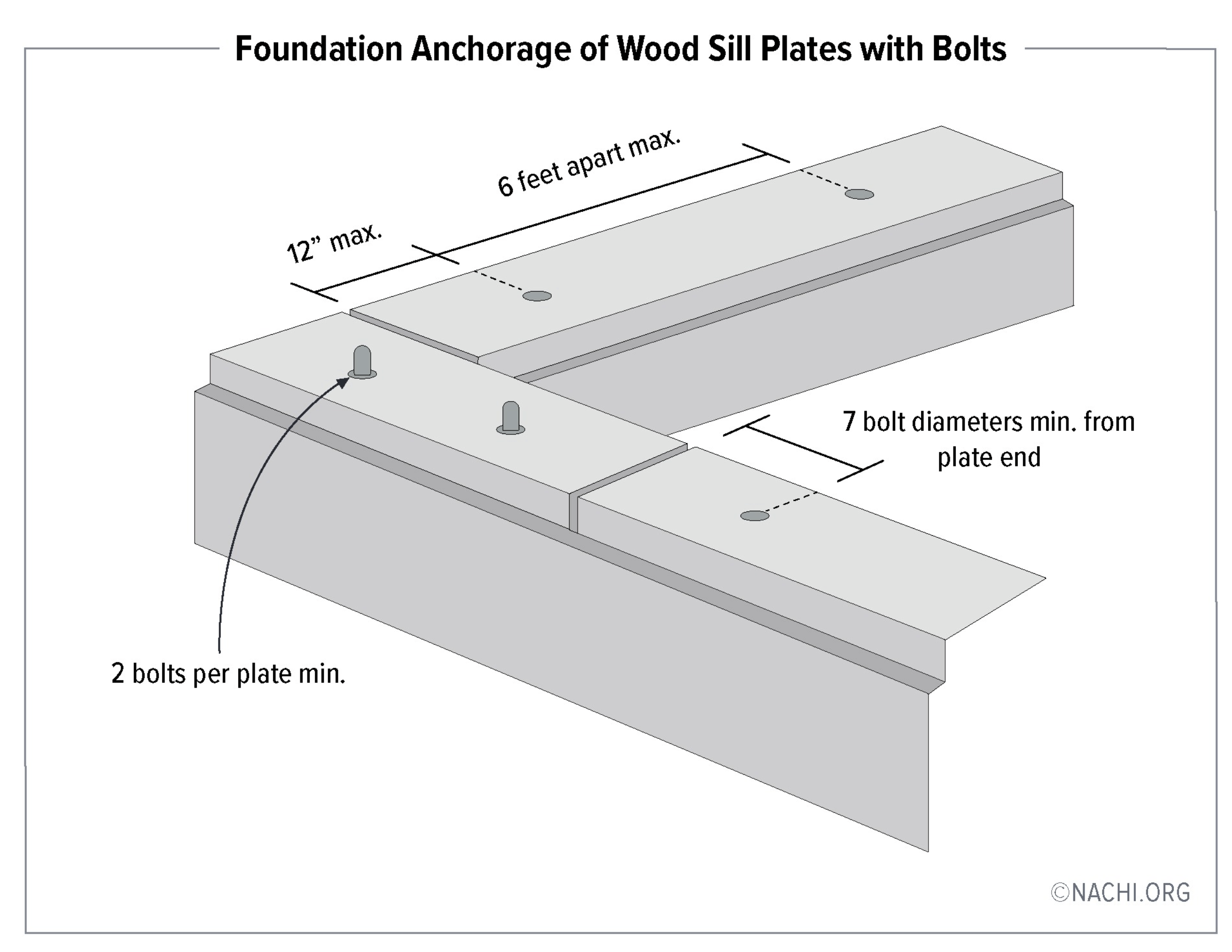

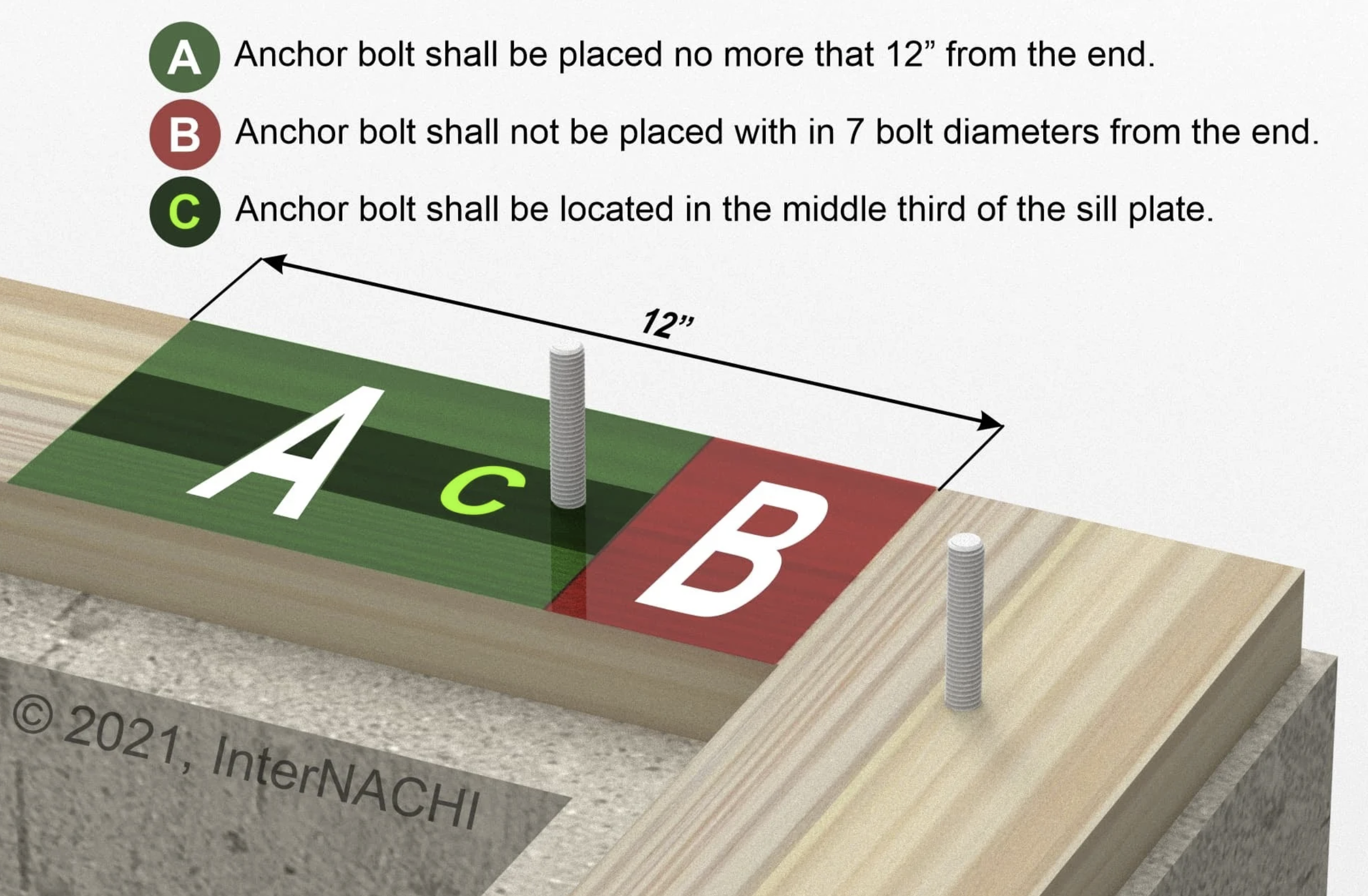

Standard Anchor Bolt Requirements for Wood Construction

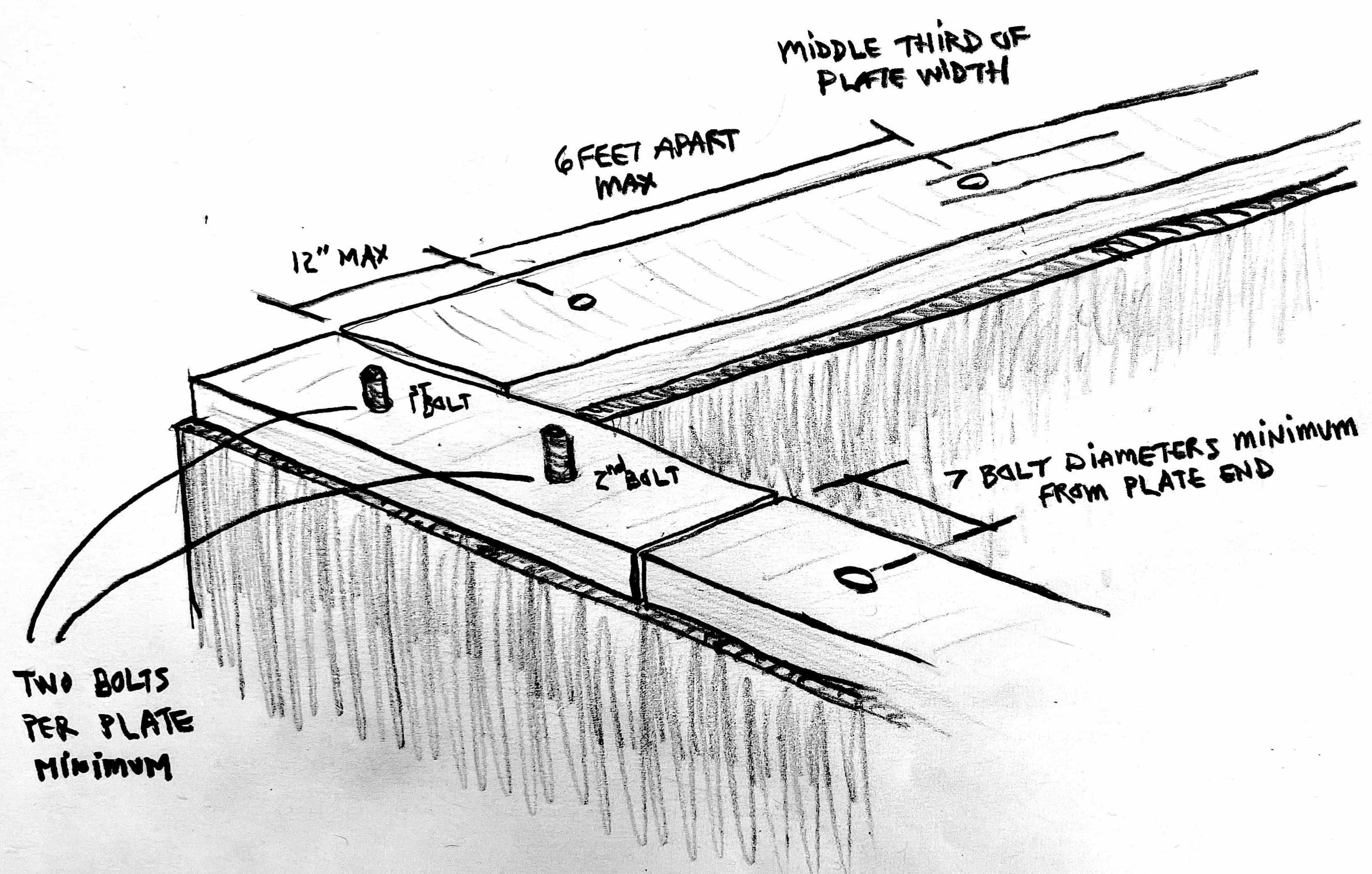

Basic Materials and Spacing
  • Required Materials: Wood sill plates and walls on continuous foundations must be anchored to the foundation
  • Bolt Size: Minimum ½-inch-diameter (12.7 mm) anchor bolts are required
  • Spacing: Bolts must be no more than 6 feet (1829 mm) apart on center
  • Alternatives: Approved anchors or anchor straps that provide equivalent strength to ½-inch-diameter anchor bolts are acceptable
Installation Requirements

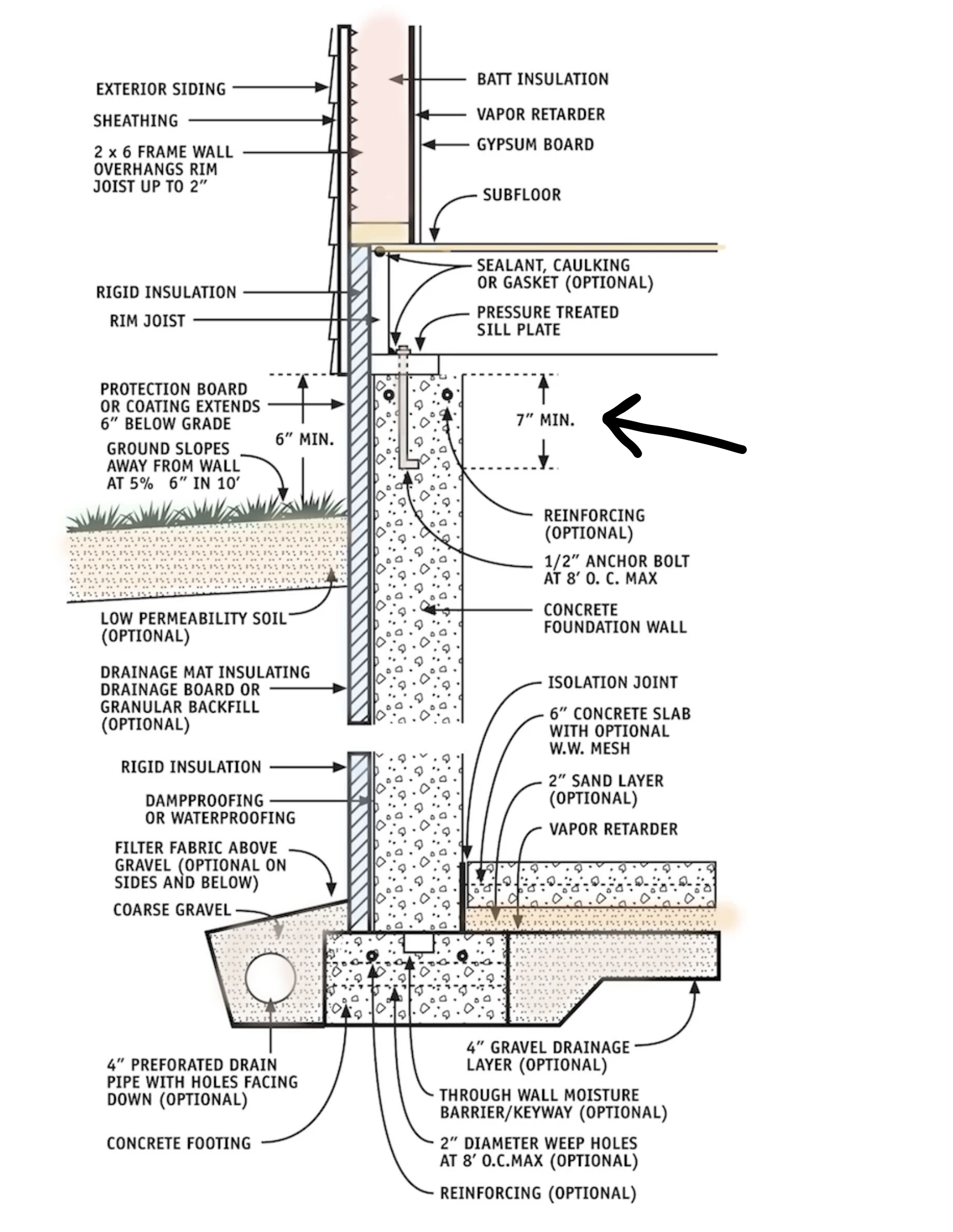

  • Depth: Bolts must extend at least 7 inches (178 mm) into concrete or grouted cells of concrete masonry units
  • Positioning: Bolts must be located in the middle third of the plate width
  • Hardware: Each anchor bolt needs a properly tightened nut and washer
  • Quantity: At least two bolts must be used for each plate section
  • End Placement: At least one bolt must be located no more than 12 inches (305 mm) or less than seven bolt diameters from each end of the plate section
The Science Behind Bolt Placement
The requirement to place anchor bolts within the middle third of the plate width comes from extensive testing, not arbitrary rules. This placement:
  • Allows some flexibility during installation
  • Ensures adequate distance from the edge to prevent wood splitting
  • Maximizes the bolt's holding power under stress
Testing has shown that anchor bolts lose significant holding power when placed closer than 1¾ inches from the plate edge. Manufacturers typically specify a minimum edge distance of 1¾ inches in their installation guidelines.
For common lumber sizes:
  • In 2×4 sill plates: Middle-third placement ensures at least 1⅛ inches from the edge
  • In 2×6 sill plates: Middle-third placement ensures at least 1¾ inches from the edge
This precision might seem excessive during a routine inspection, but when lateral forces come into play, those extra fractions of an inch can mean the difference between a stable structure and a compromised one.

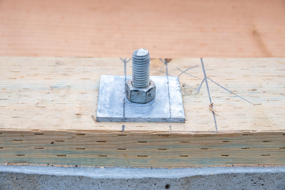

Special Requirements for Seismic Regions
Buildings in earthquake-prone areas require enhanced anchoring systems. 2024 IRC Section R403.1.6.1 includes additional requirements that were developed following observations from earthquakes, particularly the 1994 Northridge earthquake in California, where extensive sill plate splitting led to significant structural damage.
Requirements for Seismic Design Categories
Wood light-frame structures in Seismic Design Categories D₀, D₁, and D₂, and wood light-frame townhouses in Seismic Design Category C, must meet these additional requirements:
Special Washer Requirements:
  • Plate washers must be used with all anchor bolts along braced wall lines
  • Standard cut washers can be used for anchor bolts in non-braced wall lines
  • Approved anchor straps can substitute for bolts with plate washers

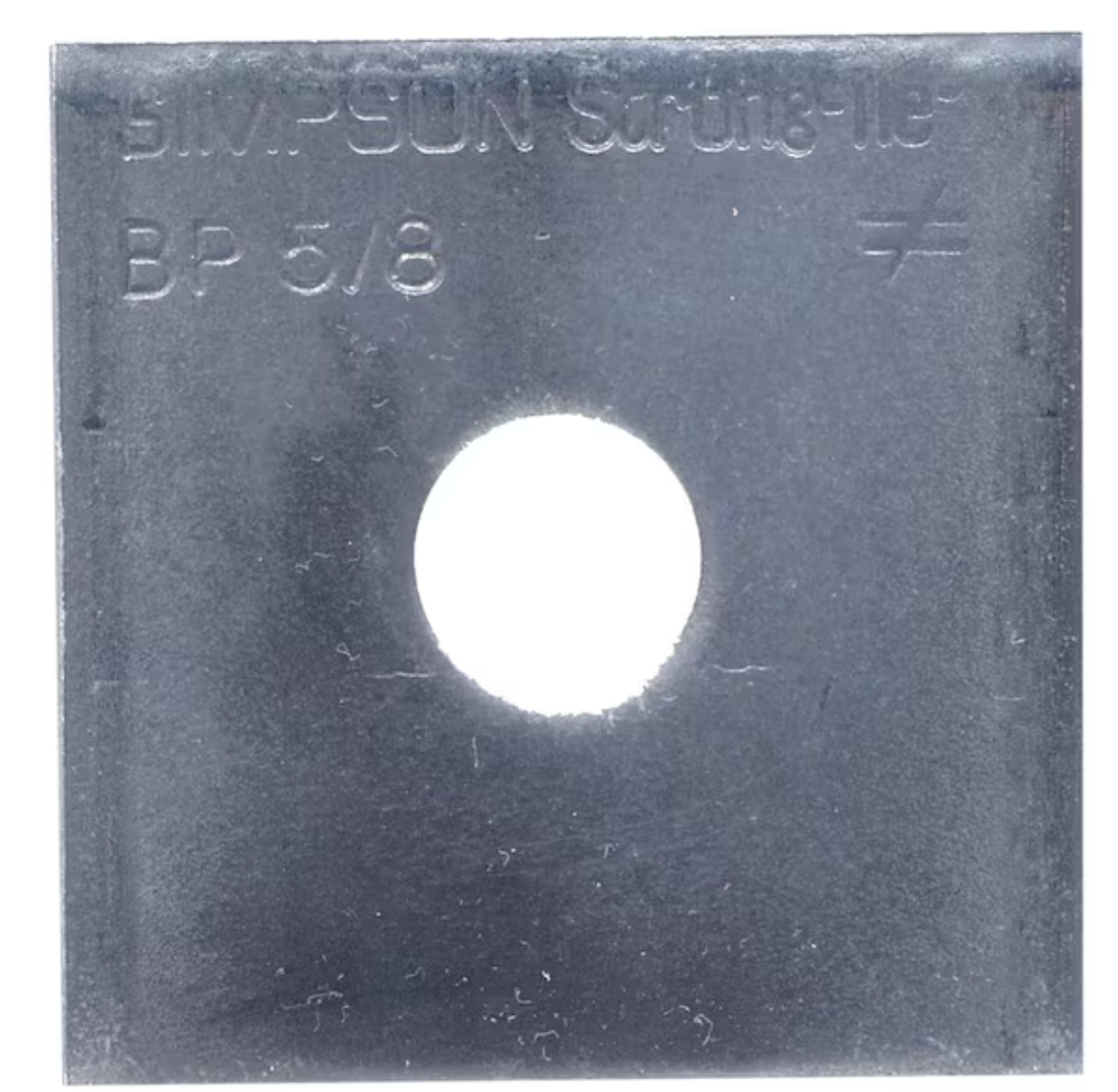

Plate washers are particularly important in seismic regions. Unlike standard cut washers, plate washers distribute force across more of the sill plate, reducing the likelihood of the plate splitting during an earthquake—a common failure that turned many sill plates into splintered wood during past seismic events.

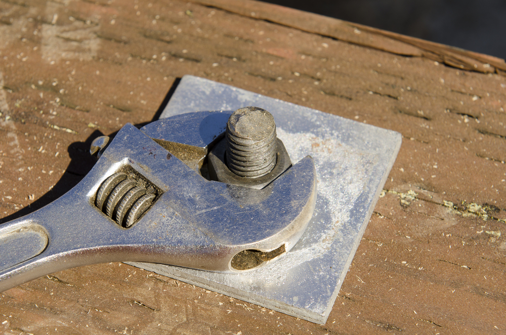

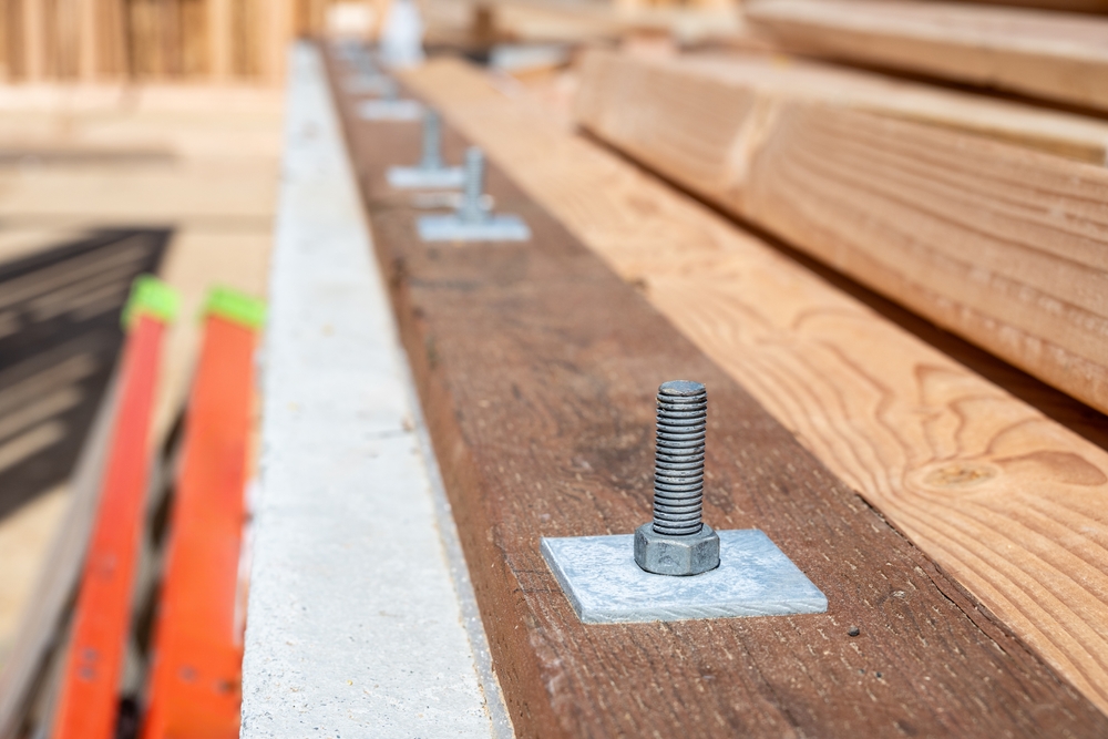

Plate Washers vs. Cut Washers in Seismic Zones
In seismic design categories C, D₀, D₁, and D₂, the code makes an important distinction between plate washers and standard cut washers, and this distinction directly impacts structural performance during earthquakes.
Plate Washers
Plate washers (also called square washers) are typically square or rectangular steel plates with a hole in the center for the anchor bolt. They have several critical characteristics:
  • Size and Dimensions: Section R602.11.1 specifies that plate washers must be a minimum of 2" × 2" × 3/16" (50.8 mm × 50.8 mm × 4.8 mm)
  • Distribution Area: The larger surface area distributes the force of the bolt over a much wider section of the sill plate
  • Failure Prevention: This wider distribution significantly reduces the likelihood of wood fibers compressing or splitting under dynamic lateral loads
  • Required Locations: Must be used for all anchor bolts along the full length of braced wall lines in applicable seismic design categories
Standard Cut Washers
Standard cut washers are the common circular washers most people are familiar with. In seismic contexts:
  • Limited Application: In seismic zones, standard cut washers are only permitted in wall lines that do not contain braced wall panels
  • Limitations: They distribute load over a much smaller area than plate washers
  • Performance Issues: During the Northridge earthquake, many sill plates with standard washers failed through splitting or "tear through" when subjected to strong lateral forces

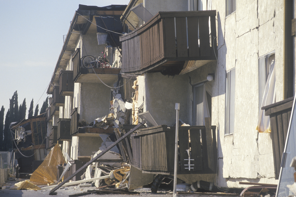

The Science Behind This Requirement
The requirement for plate washers emerged directly from post-earthquake damage assessments, particularly after the 1994 Northridge earthquake. Engineers observed that:
  • Under dynamic lateral loading, standard round washers allowed anchor bolts to effectively "tear through" sill plates
  • This occurred because the smaller surface area of standard washers created high compression forces concentrated in a small area of wood fibers
  • As the wood compressed or split, anchor bolts lost their holding power
  • This failure compromised the entire lateral force resisting system of affected buildings
The larger surface area of plate washers prevents this failure mechanism by distributing the load across more wood fibers, reducing the pressure at any single point, creating a mechanical advantage through increased bearing surface, and providing greater resistance to bolt pull-through. Below, BP stands for bearing plate.
Installation Considerations
When inspecting plate washer installations in seismic regions, look for:
  • Proper sizing: Confirm washers meet the minimum dimensional requirements
  • Full contact: The entire plate washer should make full contact with the sill plate
  • Proper tightening: Nuts should be appropriately tightened, but not over-tightened to the point of crushing wood fibers
  • Correct placement: Ensure plate washers are installed at all required locations, particularly along braced wall lines
  • Edge distance: Verify that the plate washer doesn't extend beyond the edge of the sill plate

When you think about earthquakes and tectonic movement, it makes perfect sense: if the Earth itself shifts, how much more important are the relatively humble anchor bolts that keep our buildings connected to their foundations?
Learning from Earthquakes
The evolution of anchor bolt requirements, especially for seismic resistance, reflects lessons learned from building failures. The 1994 Northridge earthquake was a turning point, exposing weaknesses in what were previously considered adequate anchoring systems.
Post-earthquake analysis showed that standard washers allowed too much compression of wood fibers during shaking, which let bolts effectively tear through sill plates. The resulting splitting compromised the entire lateral force resistance system—demonstrating that a building is only as earthquake-resistant as its weakest connection.
The plate washers now required in seismic regions spread the force across more surface area, significantly reducing wood compression and maintaining structural integrity during earthquakes. This improvement shows how building codes evolve by turning disaster experiences into better building practices.

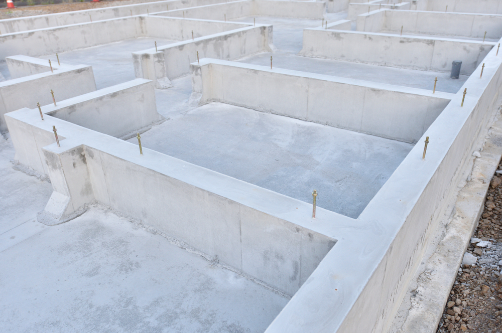

Anchor bolts can be installed in two main ways:
  1. Wet-set installation(often called "stabbing"):
    • Anchor bolts are placed while concrete is still wet and not yet set
    • This is common practice in many regions
    • Provides optimal embedment in the foundation
  2. Post-pour installation:
    • Used when anchor bolt placement during the pour is difficult
    • Used when placement would interfere with concrete consolidation

When inspecting a newly constructed home before walls are erected, with the foundation poured and cured and sill plates positioned for framing, check these key items:
Standard Inspection Checklist:
  • Verify anchor bolt diameter (minimum ½-inch)
  • Measure spacing between bolts (maximum 6 feet)
  • Check distance from each end of plate to nearest bolt (maximum 12 inches, minimum seven bolt diameters)
  • Confirm at least two bolts per plate section
  • Verify bolts are in the middle third of the plate width
  • Measure bolt depth into concrete (minimum 7 inches)
  • Check that nuts and washers are properly tightened
  • Verify sill plates have required decay/termite protection if needed
  • Check that short walls (12-24 inches) meet exception requirements
  • Verify edge distance meets manufacturer specifications (typically 1¾ inches minimum)

  • Verify plate washers on all anchor bolts along braced wall lines
  • Confirm interior braced wall plates have proper bolt spacing (maximum 6 feet)
  • Verify bolts are within 12 inches of plate section ends

  • Plate Washer Installation: Ensure plate washers are properly installed with full contact to the sill plate

  • Anchor bolt diameter meets minimum ½-inch requirement
  • Maximum spacing between bolts does not exceed 6 feet
  • Minimum of two bolts per plate section
  • Bolts positioned within middle third of plate width
  • Edge distance from bolt to plate edge meets minimum requirements (typically 1¾ inches)
  • End bolts within 12 inches of plate ends
  • Bolt embedment at least 7 inches into concrete/masonry
  • Nuts and washers properly installed and tightened

  •  Plate washers installed on all anchor bolts along braced wall lines
  •  Cut washers correctly used for non-braced wall sections
  •  Interior braced wall plates have maximum 6-foot bolt spacing
