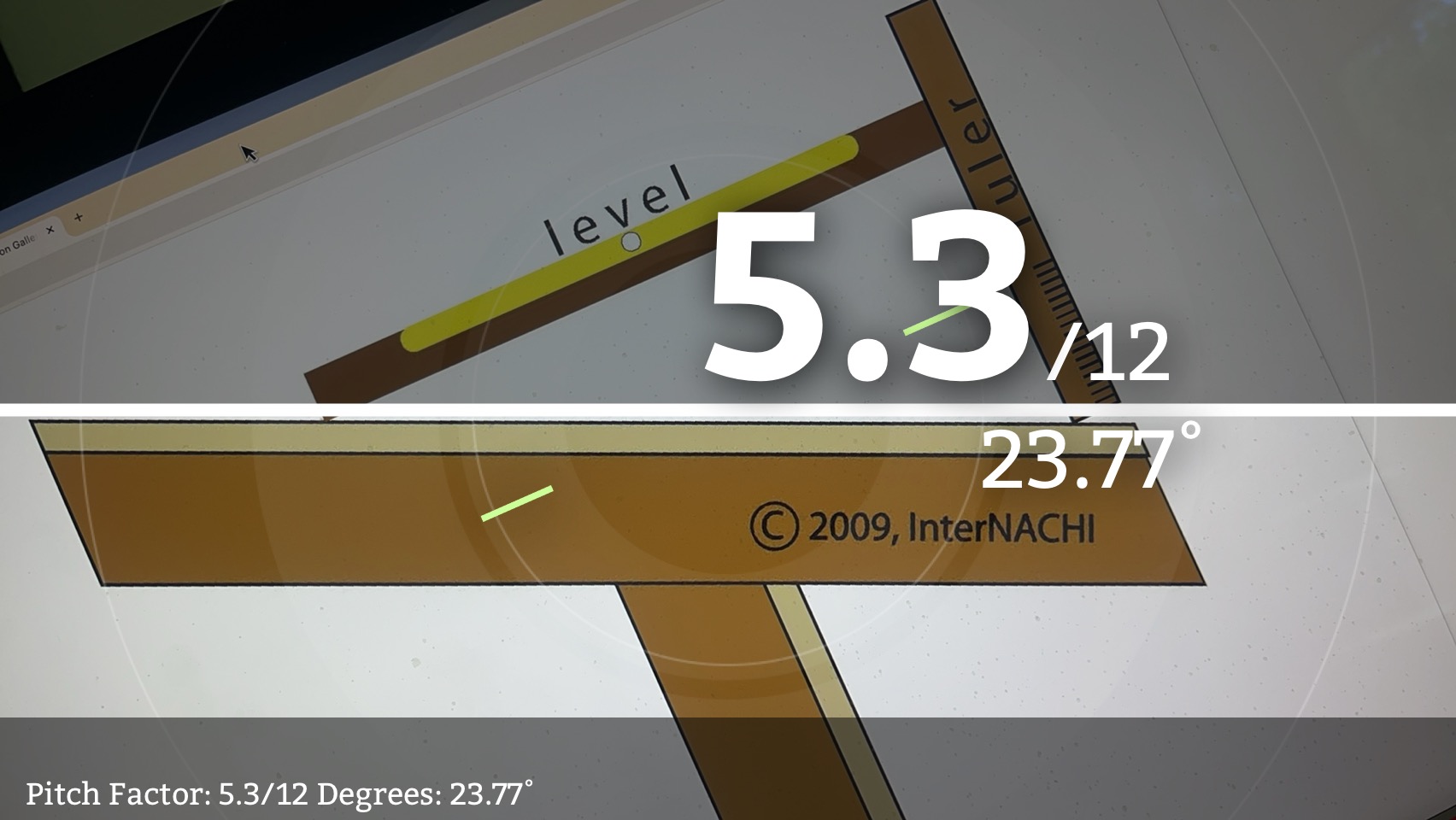

 This smartphone app is called Pitch Gauge™.
An inspector may find the use of mobile technology valuable. There are applications for mobile devices that accurately measure the slope of a roof, including the ability to take digital pictures of the slope from the ground.
Try https://apps.apple.com/us/app/roof-pitch-factor/id777976077
